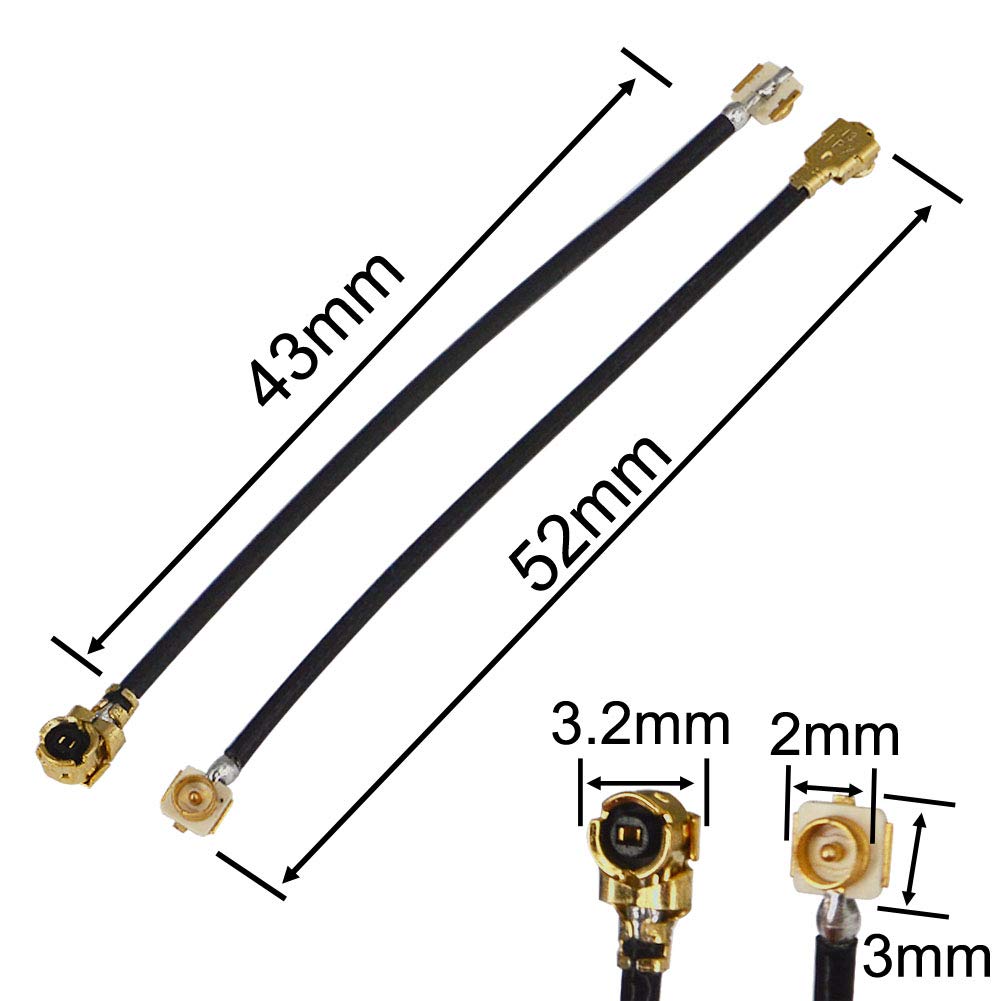

Can anyone tell me the name of this connector please? Internal antenna port..
devs
Pro Member
Might well be that U.FL, one of the Amazon links pictures even says theirs is the smallest 0.8mm connector, not the 2mm U.FL.. which matches your description ie too small.
Yeah, doesn't seem very straightforward.
Can you disconnect one of yours safely, take a macro picture of it and the socket? Hard to figure out .. so many of these things out there.
Hi Lucian, yes I think thats what I will have to do. Theres never a good time to take the router out of action! Will get it done either late tonight or early tomorrow. Thank you!
Put a ruler near them, too, check the sizes..
Morning guys, I've opened the router up and got some photos of the connectors...
Any thoughts what they are?
Thank you Gavin. puzzled!
Where did you get the images from please? I might check in with them to see if they happen to know..
You asked what the connector was you had photo's and I still think it's a U.FL one, but unfortunately my mind-reading powers failed me and couldn't tell me the connector that your external antenna cable has, meaning I couldn't search for a more suitable patch cable to convert between the two.
Haha. Ah apologies Gavin, I had mentioned this before but it was in another post. Getting confused!
These are the connectors on the end of the antenna that I'm trying to attach to...
