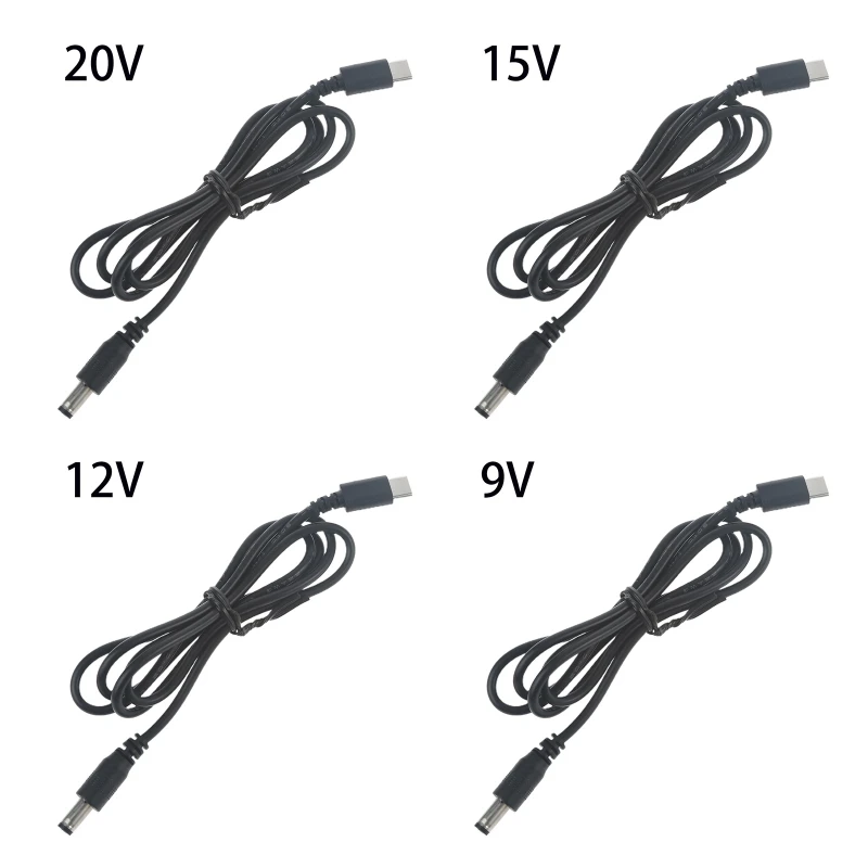

Thanks for that, so in other words this cable then (£6.24 on eBay) -
or even this -
yep those look right. they should do what you want (providing your power bank is PD and can do the same voltages, the cable just "triggers" the power bank to output that). They're life savers, I also use the same cable to power my modem in the car when we go on road trips since my phone has limited data now (I discovered I don't actually need unlimited data in my phone lol) so we just take the 5G modem with us which has an unlimited SIM. Plug into the PD 12v car adapter, off you go. Plug into a power bank while you're out and about. I love these cables.
An excellent review, that how I plan on using it too :)(y)
any PD power bank suggestions?
im using two, one is a "DIY" kit from Aliexpress that uses 18650s (because i had tons of them just laying around unused) and I also bought a really nice Inui brand one (BI-B63) 100W 25000mah one that was on offer at amazon for £30
