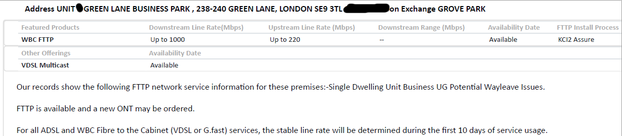

From btwholesale.com for address:
Thank you.
This is not OH so requires UG fibre install.
There are a number of buildings on site and not all may have a serviceable duct, may be subject to survey and if additional work has been identified requires an additional task (rather than just straight one man FTTP ONT install). In addition current service may be via other premises requiring wayleave/permissions/access.
The delay could infer either first install on the park or premise specific issues such as cabling at height.
However BT Business should be more specific on task and timetable.
Thank you.
The entry for your neighbours at Unit 5 is more positive:
“Our records show the following FTTP network service information for these premises:-Single Dwelling Unit Business UG Duct rodded and roped.”
This essentially means that it’s ready to go. Your entry is less positive “…potential wayleave issues”
Given it’s the same estate, suggests that the issue really is way leave related or duct issue serving your unit.
Is there a managing agent that you can speak with? They may have some insight especially if other tenants/owners have come across similar.
