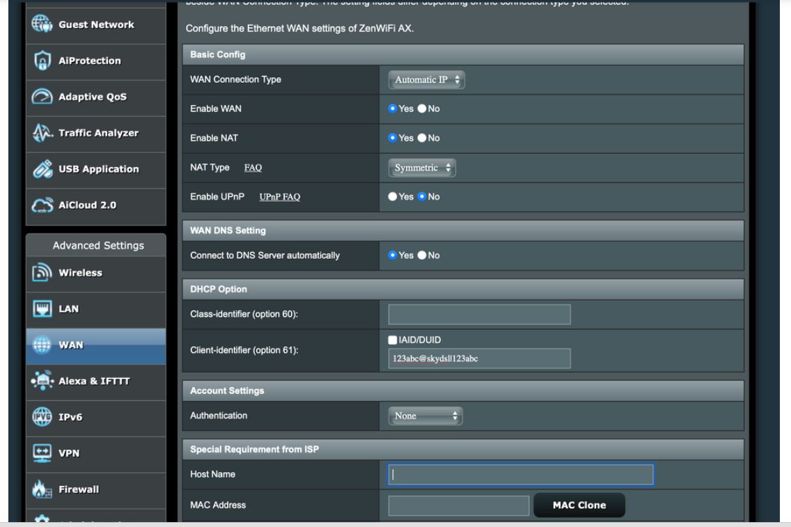

No, you would need to manually enter some settings into the Asus router, but its very easy to do this. Go to Advanced Settings > WAN > DHCP Options
Dhcp option 61
client identifier anything@skydsl|anything
Vlan id is left unticked
If asked for mtu 1500
Btw you may not need to install Merlin firmware on your RT-AC68 as the latest official Asus firmware may already show DHCP Option 60/61 in Advanced Settings > WAN.

When you are asked 'does the ISP have any login requirements?' select NO. Then follow my earlier instructions.
