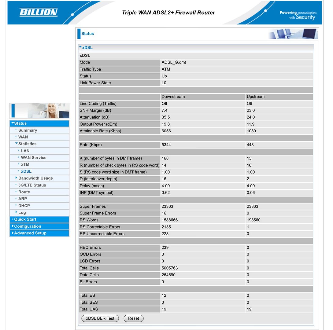

I'm not sure what you want from my router, so I grabbed this..

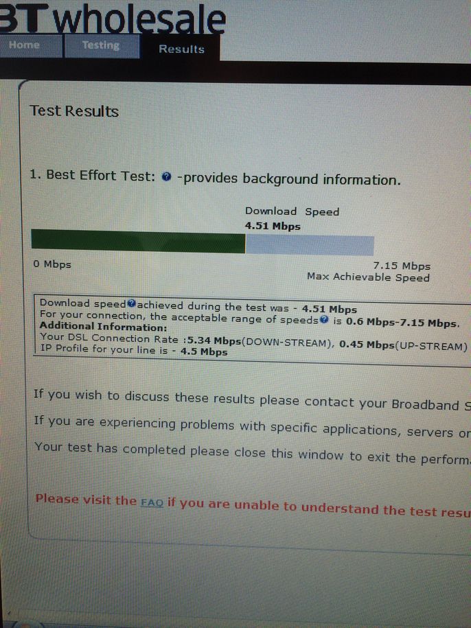

The BT test gave me this..

Looks like they've dropped your IP profile, which is capping your speed. This happened to me except mine fell from 7mbps to 2mbps! BT Openreach will be able to fix this, but it'll probably mean your ISP calling out an engineer, who'll then do all the diagnostics, agree with you, and then phone BT Wholesale, who'll change the profile!
Your downstream SNR (noise margin) is 7.4, but should be at most 6 or even lower, that means your line CAN go faster.

With his sync speed at 5.3 the IP profile he has is correct, the issue you had was different as you had a lower IP profile than what you should of done.
The IP profile depends on the sync speed not the other way round.

Nothing wrong with the SNR, it shouldn't at most be 6 it depends what sync profile the DLM system has decided is best suited for that particular line. Power cycling the router will have no effect apart from forcing a resync and wont influence the IP profile at all, it may how ever be detrimental to the connection as DLM may interpret that as a problem and either raise the target margin, up the interleaving depth and raise the INP.
What exchange are you on as it appears your on the old MAXDSL product and it may be better if you switched to a ADSL2+ product like the BT 21CN, the speeds your getting for that attenuation is below what I would expect you to get. What is your internal wiring like?
Do you have a master socket which behind the faceplate is another socket, if so plug a new filter in to that and the router directly in there with the normal cable you got with the router and check what the attenuation and SNR margin is on both the up and down streams, ignore what the IP profile is for now as that wont change for a while.
I am not 100% sure it means this on that router but its a well educated guess, INP (impulse noise protection) is enabled due to errors on the line which has lowered the obtainable max speed.

I ignored that figure as it seems to be a red herring (I've seen Billions just provide too much conflicting data before now) but focused on the Interleaving depth at level 16, which would be more of a concern, if correct. I'm just baffled to see level 16, but an SNR of 7.4 at the same time.

Tar...missed that. In that case, I think this maybe why the SNR looks low, but Interleaving Depth is right at the top. Basically I don't think we are seeing the full honest picture of the line conditions atm.

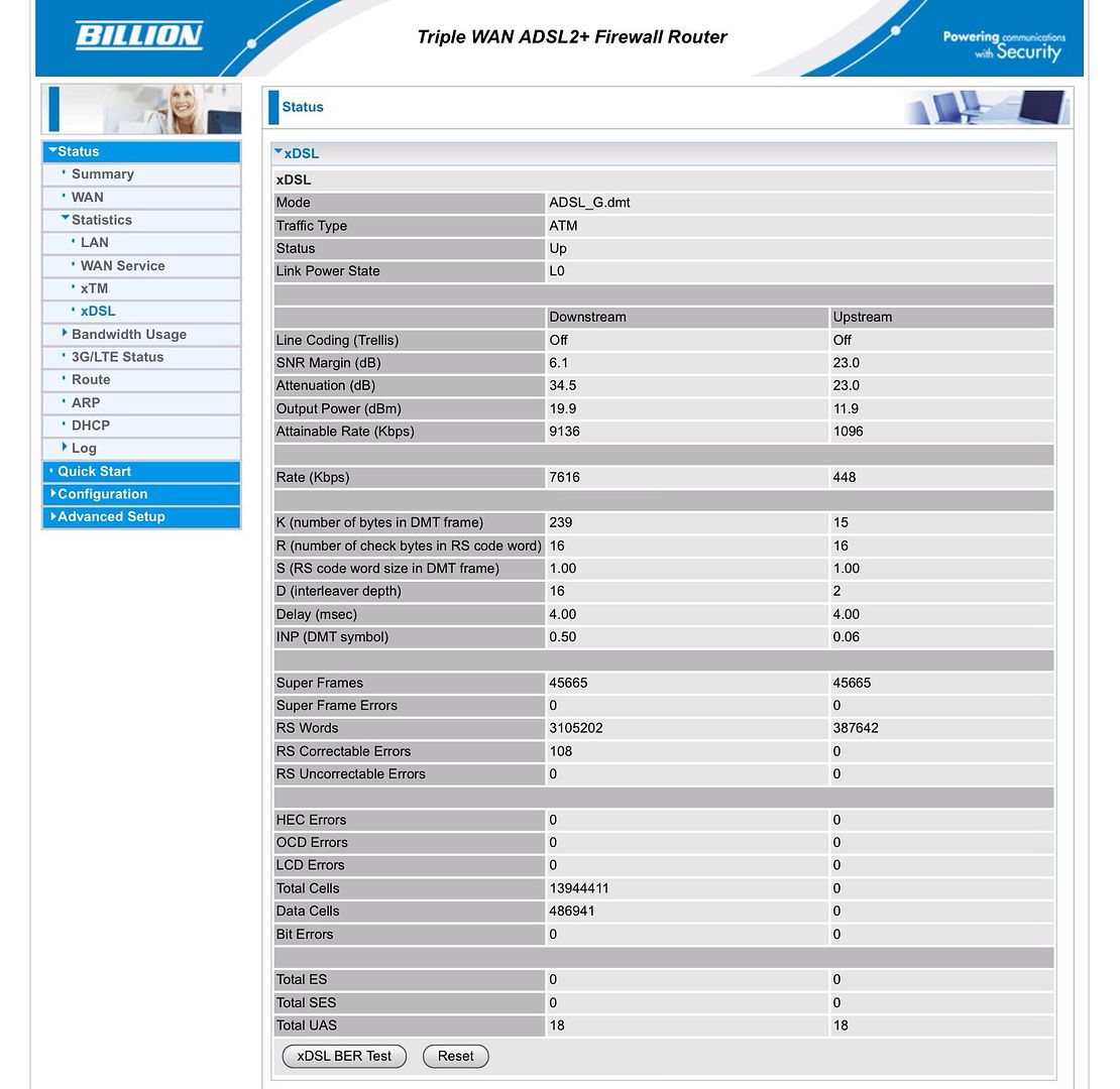

Lee, the image from the billion forum is as follows

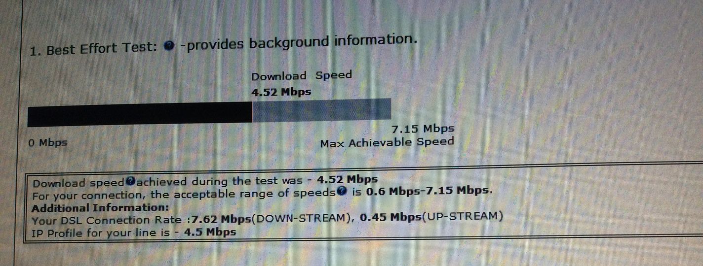

EDIT; Firmware now upgraded to latest version. Plus did the BT test again as it was all set up..
Very interesting, the noise margin keeps changing and the line sync also, but still only 4.5, mmmmmmmmmmm.
