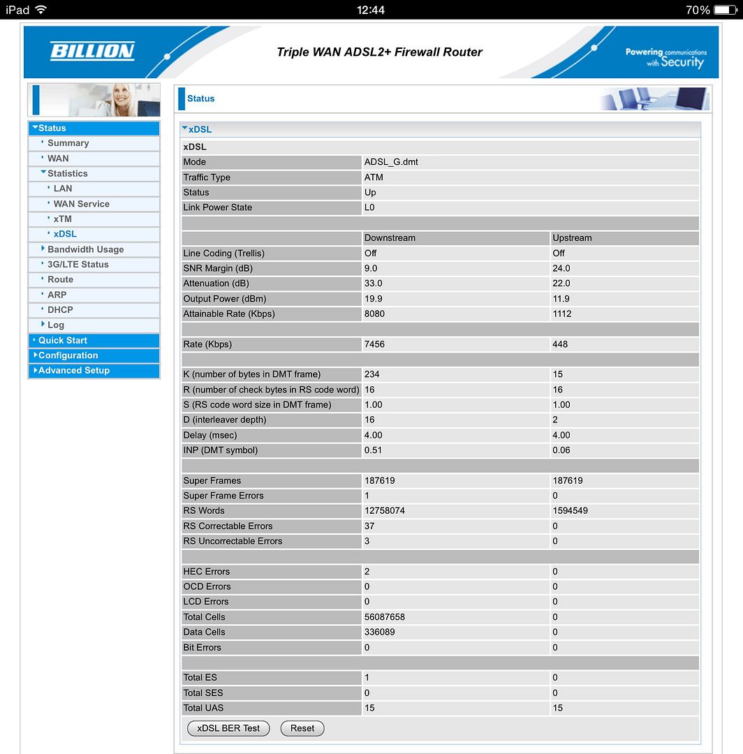

This is how the router reads atm..
Looks like with all the disconnections recently the DLM has put you on a 9db target SNR, that will get reset though, for every 3db of SNR you lower the profile you get around 800k in speed so your well in line for the max 8128 rate.
