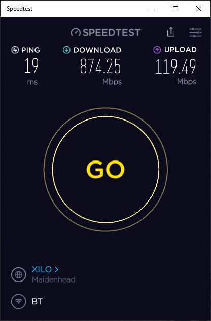

What does using the Xilo server on speedtest.net (wired test) give you? Do the test 10 times , if you get 700+ Mbps more than 5 times I'd say absolutely nothing wrong with your line. Liker I said earlier, not all speedtests can handle a 1 Gig line and its perfectly normally to see results of 300-400 Mbps on many speedtest sites.
Also if using Windoze 10, I suggest using the Speedtest app rather than using a browser.

Apologies, I wrongly assumed you hadn't tested via the Xilo speedtest server yet. Btw your upload speed also looks a little on the low side, I'm consistently seeing 115-120 Mbps on BT FTTP 900. So you might wanna ask Zen to investigate your upload as well

To be fair to Zen though, they're correct when they state the 14 days cancellation window starts immediately after you place the order. This is perfectly normal for nearly all ISPs and hence why most ISPs activate your service 14+ days after placing the order so that you have plenty time to cancel without incurring any charges.
Re: minimum speed guarantee, I believe its only BT Residential who guarantee the 700 Mbps minimum throughput. All other ISPs (even BT Business whom I'm with) use different backhaul links so - based on their capacity estimates - they may decide to play it safe and still quote 450 Mbps minimum throughput.
