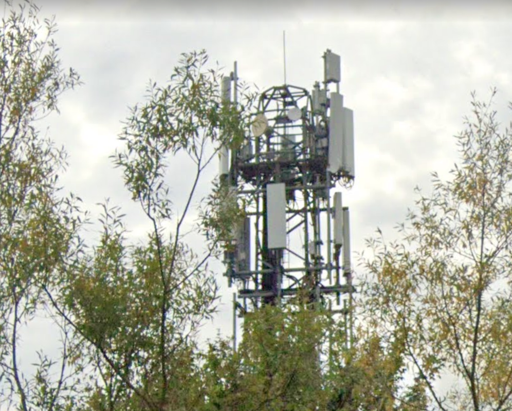

Hi, how can you tell which cell mast is the main hub with fibre connection?

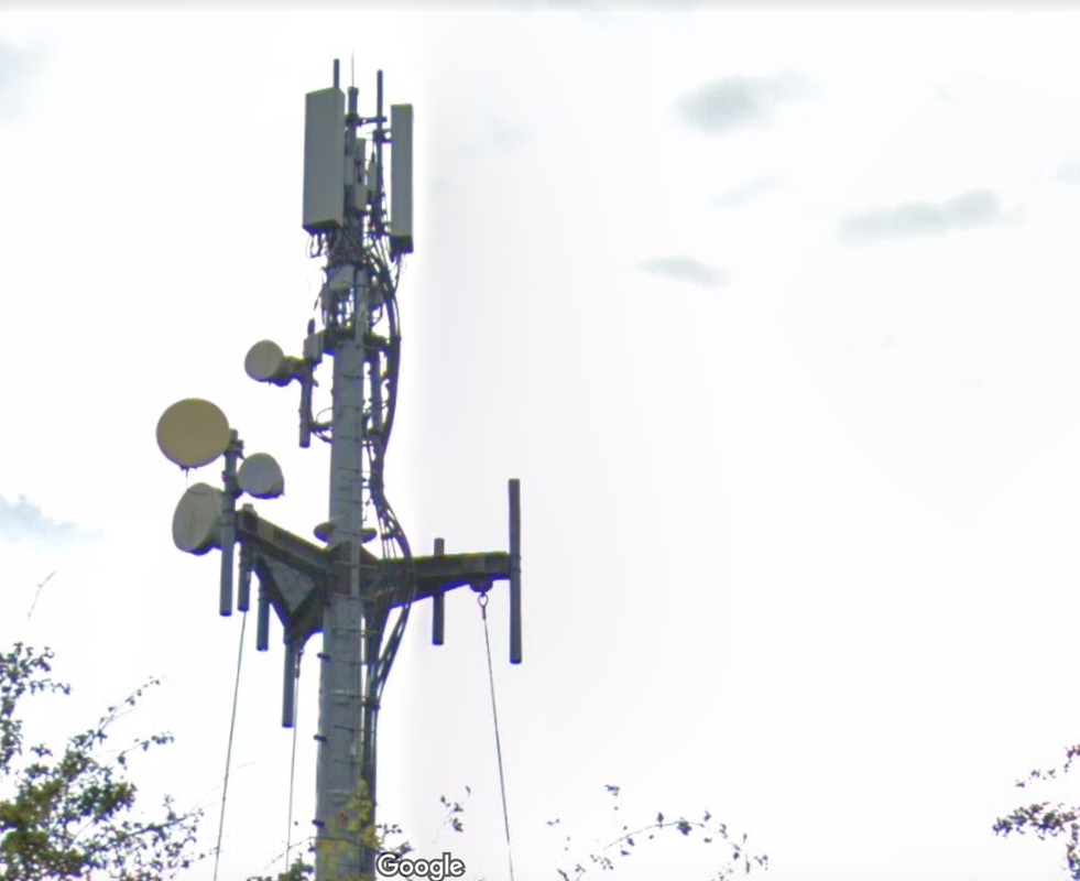

Here is a picture of one im connecting to which looks like a hub mast except one of the microwave links seems to point at an even bigger mast?
[url=https://postimg.cc/nXBJHhYq][/URL]
other mast
It could differ by operator tbh. For example I’m a hub site for Three and EE but the microwaves are only used for EE. This one seems as if they are both hub sites. The second mast is 5G, which operator is it? My guess is three. Which ever opearator has 5G on that mast it will be the other that uses the microwave links.
The first mast is ee/three band 3 and 20
Second mast is ee/three/voda/o2 This has three 5g.

It is 5G, but I think we concluded that it wasn't lit-up yet, possibly due to waiting for hardwired backhaul to go in first.
Oh yes I remember you saying that now Gavin, it's been like that for a long time now.
Yeah, I had to check back in PMs to remember, but given that Three's coverage checker doesn't show any 5G there its pretty obvious they haven't turned it on yet - just a shame that the hardware is being wasted at the moment
Yes it is indeedy Gavin, quite surprised they fitted 5G so early, unless some things needed replacing and thought they may as well do the 2 jobs at once.
