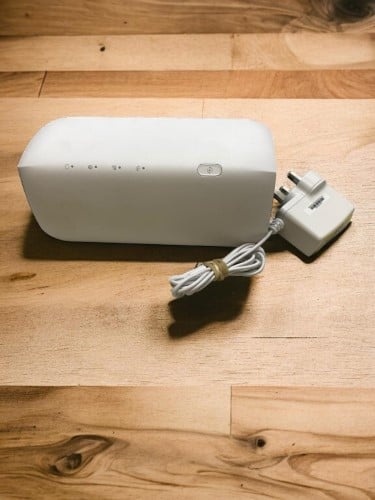

My router is a Huawei CPE Pro 2 and upon realising that my speeds are bad I send the router off for a partial modification which has given me a couple of external antenna ports. To those ports I have a Bluespot mini 5g antenna mounted to the side of my house. I'm fairly close to a mast and the antenna is facing the way it should be. The post code is S6 1AL.

Have you considered that there might be something wrong with your router?
You say that it's slow with 2 different networks and that a phone, with smaller internal antennas, gets 500Mbps... unless the router isn't good a picking the fast bands, something's wrong with it.

I think it's something to do with the router, I've heard that people have much better experiences on the NR5103E routers compared to the CPE Pro routers. Trust me from hearing people's stories, you won't regret upgrading.

CPE Pros just aren't that great if you look around online compared to the NR5103E's.

Just reporting in. It was the bloody router after all! I swapped it out for a 2nd hand NR5103E and I'm now getting 400Mbps down. Thanks to everyone to replied.
