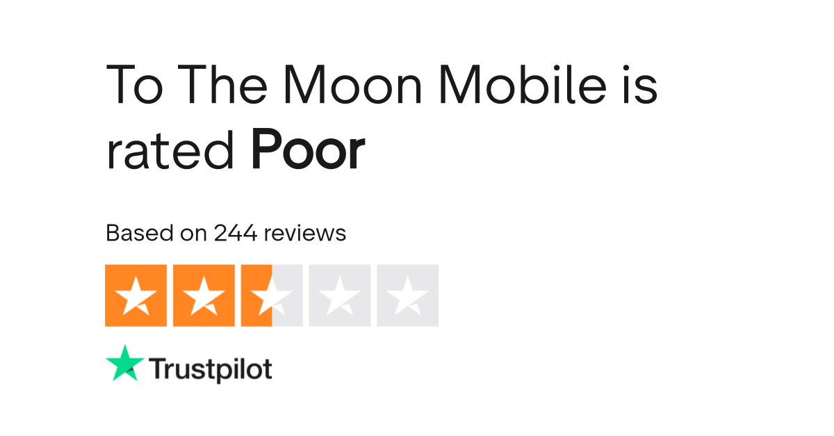

UPDATE: Upon updating my TrustPilot review I've noticed a lot of fake reviewers and even multiple reviews by the same users
Who are these people, who have I ended up giving my details too?
A load of polish people by the sounds of some of the people who run it / ran it on companies house ;)
