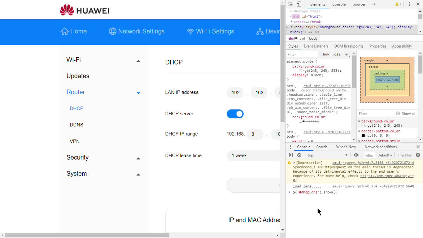

Have you tried changing the DNS server on the router as well? Three's can be really wonky and cause problems. Someone posted this a while back:
press f12 in chrome to open the dev console and then enter
$('#dhcp_dns').show();
they posted a vid too:
Set it to whatever you want, Cloudflare DNS works well for me or Google. This made a dramatic difference - far more stable all around and devices stopped randomly losing their internet connections.

Let me see how far I can get with the info and tips provided. The DNS tip is fascinating - I've seen sudden drop-outs that last for a second or two, this could be the explanation.
