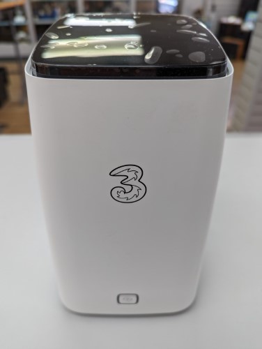

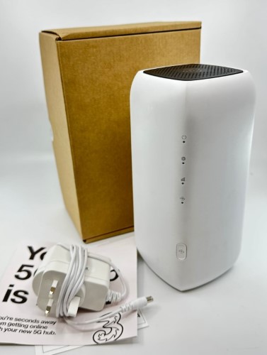

ZyXEL NR5103E Is generally the well respected router that does things well. Get one from places like CeX or cash converters so you have a bit of warranty and protection in case it got blocked in future.
V1 (My recommendation)
V2 (Smaller but a little poorer quality)
Both examples linked above should be unlocked despite the Three branding on them.
