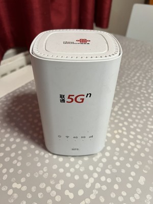

Tozed ZLT X21 review aka Unicom VN007+

Okay currently running instead of a ZTE mf286d.
The ZTE actually performed better, but maybe comparing 5g to 4g isn't fair.

1.It performs better if wireless is disabled, and you run it purely as a wired router or ip passthrough modem.
If I compare it to the Quectel in my Chateau 5G, same location, Quectel 300 down, X21 500 down.
2. yes see https://github.com/mattfaraday/vn007 the X21 and the VN007+ are the same device, they share firmware etc
