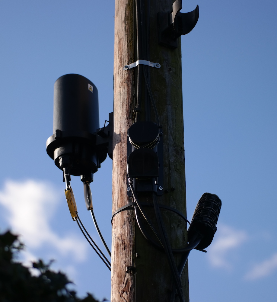

They fitted one of these to the pole yesterday. A check on BT wholesale though says "The exchange is not in a current fibre priority programme" and "FTTP is not available.".
Do you see any work mentioned on https://bidb.uk in your area from an altnet?
Edit: Ignore me, completely missed where you said OR's website confirmed the rollout earlier.
That’s a Prysmian small TM fibre joint.
These will be positioned on the fibre route. They are splicing together different elements of the fibre run.
On an FTTP serving pole a CBT will be mounted at the top of the pole, from which your drop connection is taken.
Here’s a photo of a pole with this sort of a setup with a joint and a CBT. this is one of several along the fibre path down my lane. Fibre from the splitter node (1/2 mile from me) running at the very top of the pole. Copper is the much thicker cable in the middle.
That's exactly what the pole just outside my house looks like now.
