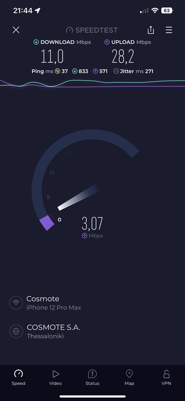

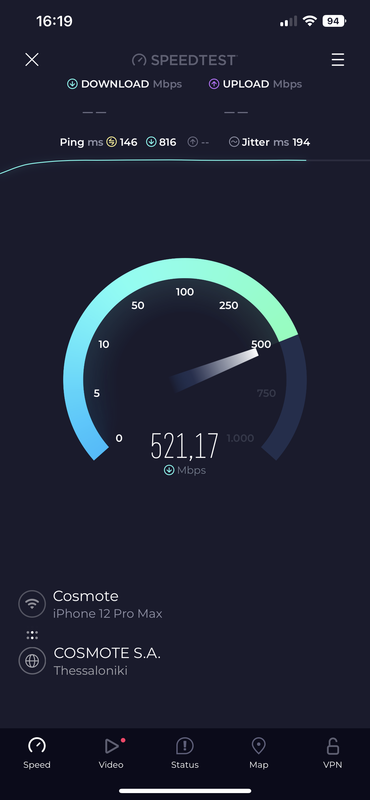

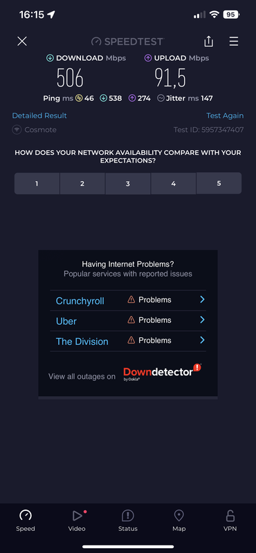

Hello guys , i live in Greece and recently received sim card with ZTE mc801a but iam dissapointed cause i dont know what to do either i got 400-500 down and 80-100 up with 40-50 ping and in gaming its not very good , and either i got 11 down 28 up with 37 ping , i look sometimes ping goes very high and reason ? And what should i do? Would be glad to hear suggestions i only tried moving from wall to wall to see whats the best for router , my router says i ve got full signal here are some photos
